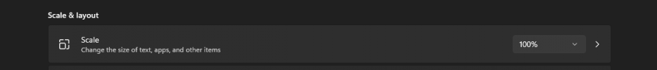

Set Monitor Scaling to 100%, it's currently 125%

these are my settings i also Set Monitor Scaling to 100%
but i noticed that a part of my recording to the right is clipped out for some reason if u noticed in previous images

Monitor scaling is OK now but you're still using Display Capture with a scaling filter & B Frames/Visual Tuning are still being used in your encoding settings. B frames are the lowest quality frame type...
