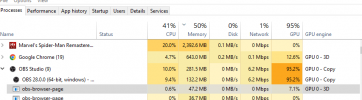

Heres a image of my task manager showing obs at 95% GPU no device manager adding to it.
Download the zip file of OBS, create a portable version and see if this still happens when you open it with no scenes and default settings.
Please post a log file from when OBS is using that much GPU. Also, the image is cut short not showing all the processes.
